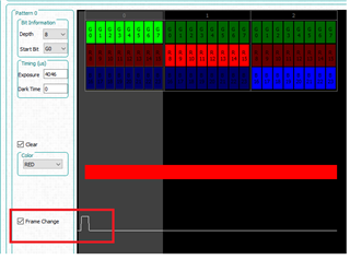

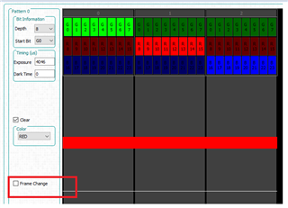

    I have noticed, when there is no "Frame Change" input enabled for the first pattern, flicker is observed on left portion of displayed image.
    "Sequencer Abort Status Flag Error" flag is also set continuously.
    Video pattern mode needs "Frame Change" enabled for first pattern. Since the internal frame memory gets updated with new data for every frame, internal Sequencer hardware needs to wait for the "Frame Change" input trigger before it can start reading the memory contents and display the pattern sequence.
    After enabling "Frame Change" input for the first pattern, video patterns show properly on the screen and display is also proper without any image artifacts.
    There is no error reported by the sequencer as well.
    Please check with customer if they have enabled "Frame Change" trigger for the first pattern or not.
