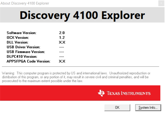

Hi there,
I have been trying to load a script onto the Discovery 4100 Explorer application but am constantly getting an Runtime Error "6" Overflow error popping up. Can I ask what is the best way to solve this issue?
Thank you.

  • Jeremy,
    The other information from the about screen will be helpful also.  The one shown above.
    Also how many lines are in your script?
    Fizix

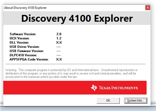

  • Hi Fizix,
    Kindly find below the information about the screen as you requested.
    The above is what i have gotten when i click on help > about.
    My script is about 4000 lines long.
    Thank you.
    Jeremy
  • Jeremy,
    Is your system connected?  The USB Driver Version, USB Firmware Version, DLPC410 Version, and APPSFPGA Code Version should be populated. The controller board needs to be connected and powered on.  The GUI should report that it is connected in the lower left hand corner.
