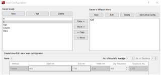

There is a phenomenon when using DLP NIRScan Noao to scan with small pixel width setting (ex. 2.34 nm) in column mode.

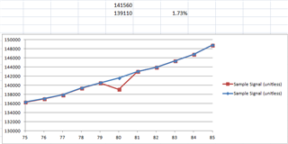

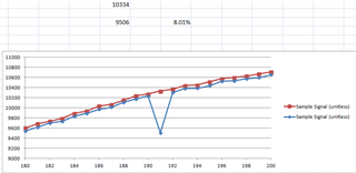

The waveform glitch were found in the scan configuration and randomly with different scans.

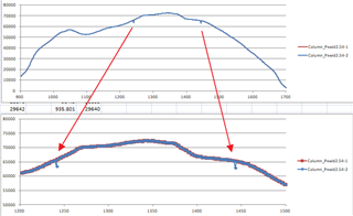

For example of below picture, there are two scans with column mode, pixel width 2.34nm.
The first scan has no glitch but the second scan appear two glitch.

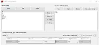

This phenomenon will be gone if the pixel width increased of using hadamard scan.
