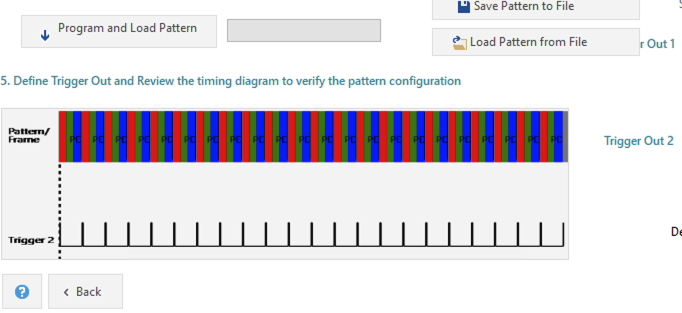

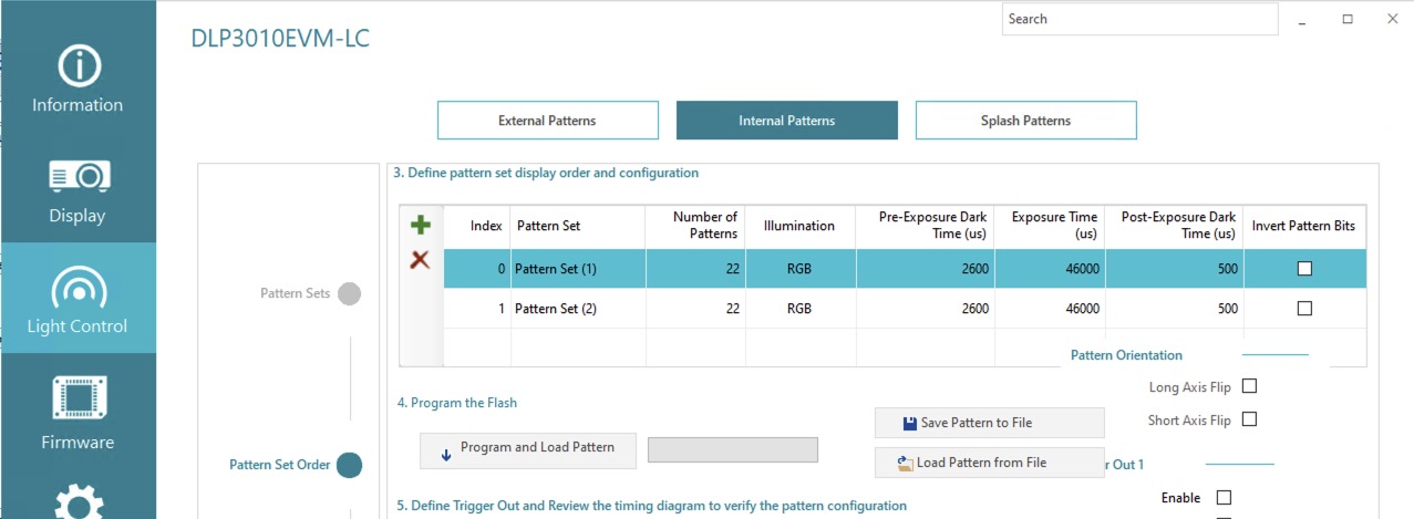

I selected RGB in Illumination, Internal Patterns, Light Control. But the light color is not white.
I would like to know the operation for white color illumination.

Could you please let us know what is the color you are seeing when you say "light color is not white".

Liang,
As indicated in the Patterns/Frame timing diagram - the patterns will be displayed in R,G and B illumination sequentially based on the exposure time settings.

Hello User,
There is not a way to change the whitepoint while using this feature.
An alternative would be to replace the red LED with a white one. TI has a red only FW image in the Pico FW Selector Tool. TI has tested and validated this EVM with only RGB LEDs.
