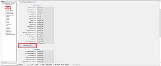

    If you are using the EVM firmware (EVM Firmware: 7.1.2 on the Information tab), the 6000mA current for the green and blue LED's is expected. the red LED should be pulling roughly 4534 mA.
    Please try navigating to Status menu in the Advanced GUI. Issue the Read System Status command. Do the return parameters differ from what can be seen in my screen grab?
    Additionally, were you able to successfully re-flash the board?
    Austin
  • Hi Austin,
    I was able to re-flash the board. I downloaded the most up to date firmware and flashed it. After looking in the advanced system settings, the system status is all the same for the board as the picture you sent. There must be something wrong with the LEDs or the illumination circuitry. I can visibly see the DMD inside of the light engine optics moving as I update the image being sent to the EVM. Changing from a solid field pattern to a different one changes the DMD, and I can see it if I look through the lens of the EVM. For some reason, I believe theres an issue with the LEDs. In the Illumination settings, the CAIC RGB LED currents are all at 0, but the RGB LED currents are all around 1000. Not sure if this has anything to do with it.

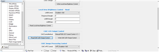

  • Joshua,
    So long as CAIC Is disabled the CAIC RGB LEG currents should not be an issue. You can confirm that CAIC is disabled within the Image menu. There is a Read CAIC LED Output Control command that will return 0x0 (Manual RGB LED Current Control).
    Can you confirm the power rating on your supply? The GST90A19-P1M should be rated to well above the needed current, but it could help to be sure there was no mix up.
    If we are investigating the LED circuitry, what is the resistance between the anode and cathode for each LED with the board disconnected from power? This should be in the order of a few hundred kilo ohms.
    Also, what is the voltage difference between the LED anode and cathode? Is it possible for you to connect a current probe on the LED lines to observe the current?
    Austin
  • Hello Austin,
    I've measured the resistance across the LEDs. The red and green LEDs are measuring around 110-114kOhm, but the blue LED is significantly lower. It's measuring around 150Ohm. The voltage differences are as follows: Red - 9V, Green - 5.4V, Blue - 20.6V. I'm finding it difficult to connect a current probe.
