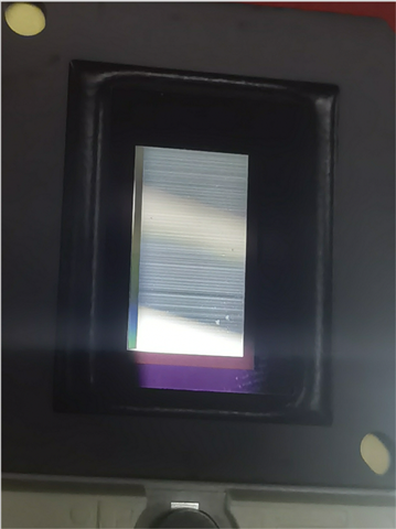

    I exchange the DMD chip on the two EVM boards we have, and something confusing happened.
    Let me label these two EVM boards as 'old one'(which has some problems) and 'new one'(which we haven't used before). And the same for these two DMD chips as 'old one' and 'new one'.
    Initially, the 'new' DMD on the new EVM just works well, while the 'old' DMD on the 'old' EVM cannot work.
    And then I exchanged the DMDs. The 'old' DMD worked well on the 'new' EVM. However, the 'new' DMD cannot work correctly on the 'old' EVM(see figure below).
    What is really confusing is that, after I return the 'new' DMD back to the 'new' EVM, it cannot display clear images(although it still can work and control, there are always some annoying strings on the DMD screen, please see figures below).
    Please advise.
    Keep safe.
    Josel

    They are currently using the 5.0.0GUI and 6.0.0 firmware now. The behavior of the 'new' DMD on the 'new' EVM board is shown below, from different angles.
    Still, the image looks broken with many uncontrollable strings(though there is indeed an image).
    For the 'old' DMD, sadly they have not followed the instructions when moving the power. But for this 'new' DMD, it is brand new, except that they replaced this DMD chip on the 'old' EVM board for testing once. And when off-power, the 'new' DMD now looks as follows, which is very terrifying. seems that it is broken. But what they did to it is just replace it on the 'old'(and suspiciously broken)EVM board...

  • Hello Joselito,

    Regarding the device that does not seem to be working after restoring it to the "new" EVM. Please try powering up, then go through a "Standby", allowing the full time to complete the timer (a little over two minutes).  I would repeat this several times and see if this recovers the DMD.
    Does the "old" DMD still work well in the "new" EVM.  If so, and the Standby does not recover the "new" DMD, then inspect the pins on the back of the "new" DMD to see if any are bent.  Also inspect the ZIF socket for any issues with the contacts.
    Let me know if this uncovers anything.

    We tested the new DMD on the new EVM as you suggested. We powered it up and then went through the standby two times, and carefully checked the pins on the DMD chip(and found that one or two pins are bent very slightly). We carefully re-mounted the DMD on the EVM and found that it was recovered.
