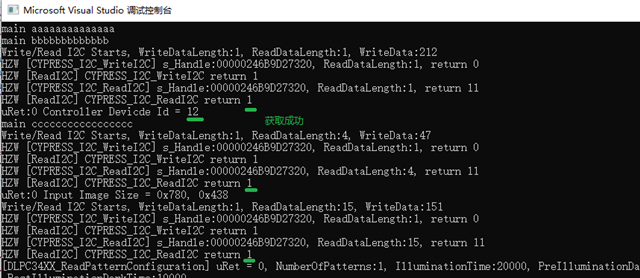

The customer migrated DLPC3479 sample codes(https://www.ti.com/tool/DLPC-API)
to Qt 5.12 + MSVC2017 64bit  Release ,cyusbserial.dll
But CYPRESS_I2C_ReadI2C failed.
1----samples .c added into Qt cpp code, as shown in picture 1
                                                                                          Picture 1

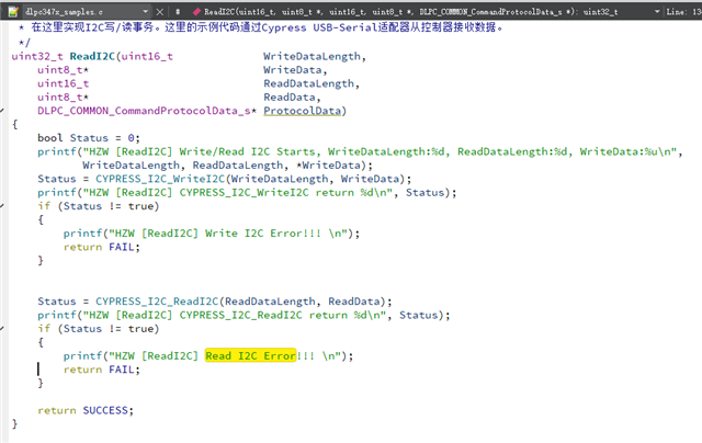

2----CYPRESS_I2C_WriteI2C  is good , but CYPRESS_I2C_ReadI2C  failed。as shown in picture 2
                                                                                         picture 2
3----in QT library  Write command is successful. but Read  command is failed as shown in picture 3.
4----use VS2017 running samples(pure C)to do the test , 64 bits library is good as shown in 4 and 5.
                                  Picture 4                                                                                                                                  Picture 5
Please check how to use DLP3479 in QT.

  • Hello Jeremy,
    Our samples generally link against the 64-bit version of the Cypress DLLs, as seen in our CMakeLists.txt file:
    find_library(CYUSBSERIAL cyusbserial third_party/cyusbserial)
    Your `dlpcQtDemo.pro` file seems to always link against the 32-bit DLLs, as seen here:
    #32位库
    win32: LIBS += -L$$PWD/../M11B/DLPC-API-1.10/third_party_32/cyusbserial/ -lcyusbserial
    INCLUDEPATH += $$PWD/../M11B/DLPC-API-1.10/third_party_32
    DEPENDPATH += $$PWD/../M11B/DLPC-API-1.10/third_party_32
    #64位库
    #LIBS += -L$$PWD/../M11B/DLPC-API-1.10/third_party/cyusbserial/ -lcyusbserial
    #INCLUDEPATH += $$PWD/../M11B/DLPC-API-1.10/third_party
    #DEPENDPATH += $$PWD/../M11B/DLPC-API-1.10/third_party
    I'm not positive, but this could be the cause of the issue. Unfortunately the error code you're getting from the Cypress library isn't very helpful (return code 6 == CY_ERROR_REQUEST_FAILED)/
    Could you please try linking against the 64-bit DLLs and let us know if it still doesn't work?
    Andrew
