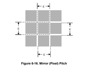

Hi Experts,
Good day.
I am looking for the gap between the pixel. Please help.
ε = 5.4 micrometer
Keep safe
Josel

Hello Josel,
Welcome back to the E2E forum and thank you for your interest in DLP® technology!
Can you please share the reason why you want to know the size of the gap between the pixels?
The size of the gap between the pixels is not published specification.

Hello Josel,
Thank you for your patience. Could you please share wavelengths and Optics F./# you would like to simulate? I may be able to provide you the efficiency for those values.
The Pixel gap is not part of DMD specification and not published. It is manufacturing process control parameter.

Hi Vivek,
Good day.
Here is the wavelength = 0.405 micrometer
And the F/# = 2.75482
Josel
Hello Josel,
The TRP pixel diffraction efficiency at 405nm and F/#2.75482 is 80.82%
