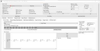

Hello, my silftware is DLP LightCrafter4500, the work interface is as follow.
This file is what I mention above.

I still have a question is that if I want to use the reference code in SOFTWARE DEVELOPMENT KIT (SDK) for DLP450, in the PLD solftware which place should I modify or add these reference code. I found the file for ''GUI'', is this place what i'm looking for? thank you.
It is very difficult to answer this question. I would first start with GUI as it and make changes as needed.
