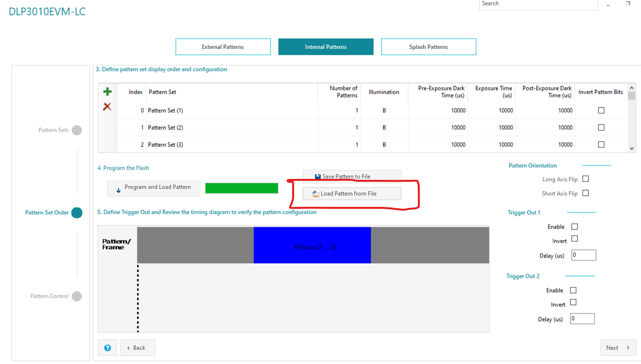

Hi Teams,
I am using DLP3010EVM-LC to generate pattern using internal pattern. However I failed save pattern to file (*bin) as the error below.
Could you please help me with this problem?
Thank You

    I need to save the Pattern to file which will used for Pattern Data File in Edit Firmware. So may I know how to validate the Timing? Even having this error, SDK also able generate a binary file. But I fail to load the binary file.

    My DLP EVM GUI version is 3.1.0.7. When using Firmware -> Edit Firmware -> Advanced -> Pattern Data File to upload the binary file, it didn't show any error but also didn't project any images (maybe is batch file setup problem).
    When I try load pattern from file as following figure, it will show error and fail to load the pattern (projected pattern same as previous pattern).
    Thank You

    We have noticed a known issue with the Edit Firmware tool, including uploading pattern data file. We are in the process of fixing the issue, and will release a new GUI version, but we don't have an exact release timeline.
    To verify the timing of the patterns, you are able to use Trigger out signals in Pattern Control page and measure them with an oscilloscope. After verified, please check if you are able to load pattern.
