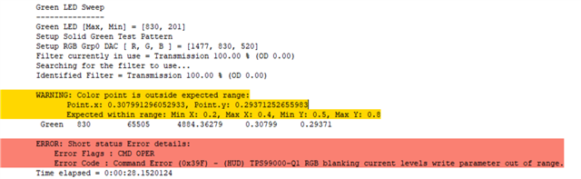

Hi!we performed the auto-calibration in DLPC230 Control Program for our PGU, but there always occured the same error as shown below, resulting in the failure to auto-calibration.
We have't been able to solve it, i want to kown what is the cause of this and how to solve it, thank you!
  • Hello Li Zhao -
    What version of the Control Program are you using? Do you have access to the mySecure Software page, where new versions can be downloaded?
    We recently added a feature to newer versions where certain error codes can be ignored, which I believe is the right approach in this case.
    Ross
