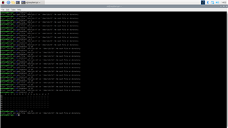

  • Hello Tokuji-san,
    We have found that some 5V supplies have a fluctuation on their voltage output. For example, some supplies listed as 5V are actually supplying 5.1 or 5.2 volts. Version 7.3.14 was uploaded to the EVM product page last year with a lowered initial LED current to ease the initial power demands. However, we find that a 5.2V supply works more consistently as you have found.
    Regarding the Python error that you are experiencing, it appears that the active I2C bus is not being found. Please trying running the following commands without including "sudo":
    i2cdetect -y 1
    i2cdetect -y 7
    i2cdetect -y 22
    One of these will likely return an active I2C bus. If not, it may be necessary to cycle through additional numbers. With the correct I2C bus, the printout should appear as:
    Once this is found, this number should be used for DEFAULT_I2C_BUS in the i2c.py module.
    Alternatively, this might be found in the /dev directory but should be confirmed with the i2cdetect -y command:
    Please let us know if this resolves your issue.

  • Hello  Austin
    Thank you for your reply.
    I tried it and it doesn't seem to detect an active I2Cbus.
    I also checked the Dev directory and it seems that there is no directory other than "i2 c -22".
    Is the cause on the EVM side? Or is it on the side of Raspberry Pi?
    On the other hand, the script for "flash _ write _ fpga.py" seems to work, but what is the difference from "python init _ parallel _ mode.py"?

  • Hello Tokuji-san,
    It is difficult to pinpoint the issue to either the EVM or Pi. It appears that the communication between them is not properly established. The "flash_write_fpga.py" script primarily issues commands over the Raspberry Pi terminal while "init_parallel_mode.py" issues commands to put the DLPC into the proper configuration for video streaming using the I2C API.
    How are you certain that "flash_write_fpga.py" is properly writing? If you open this script you will see the following line:
            Summary = WriteDisplayImageCurtain(1,Color.Black)
    If you alter or comment out this code does your process change at all? It is possible that this script appears to execute properly because there is less feedback from the controller for the Pi to realize that its transmission is not being received.
    You have mentioned that you de-bugged the power supply issue for the EVM. Can you confirm that the EVM is powered (without turning off) and properly connected to the Pi with the ribbon cable?

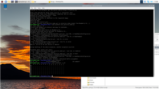

  • Hello Tokuji-san,
    Thank you for the new uploads. They appear this time.
    After some investigation, it appears that this issue is arising due to the recent Raspberry Pi update. The new update has the SPI and I2C interfaces disabled by default. Please try enabling these interfaces in the Raspberry Pi Configuration page or by entering 'sudo raspi-config' in the command line.
    After making this change, please reboot the Pi and try to detect the I2C bus as described in the Quick Start Tutorial.
    Please let us know if this corrects your issue.
    Austin
  • Hello Austin,
    I followed the instructions and tried, but the situation did not change.
    So I borrowed a working EVM from a Japanese TI engineer to carve it out.
    The borrowed EVM has a return value in i2cdetect and the "init_parallel_mode.py" command now works correctly to project the raspberry pi screen.
    So the problem seems to be with the EVM I bought instead of the raspberry pi.
  • Hello Tokuji-san,
    Is this EVM connected to the same or different Raspberry Pi? If it is a different Raspberry Pi, please try connecting it to the Raspberry Pi with which you were finding difficulty to the working EVM. This will allow us to ensure that the issue lies in the EVM.
    Austin
  • Hello Audtin,
    I use the same Raspberry Pi.
    I also tried it on a Raspberry Pi 3B that I borrowed additionally, and the results are the same as the previous Raspberry Pi 4.
  • Tokuji-san,
    I have sent you a friend request to collaborate about this issue off of the E2E thread. Please accept so that we might continue.
    Austin
  • Hello Tokuji-san,
    Please consider this post an approval for RMA of the failing DLP230NPEVM unit.
    Austin
