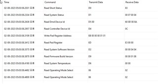

  • Hello
    Among the functions of DLP software, I would like to implement the Display Setting - Scale Input Image to Size (Width , Height) function in C# ( .net ).
    I am studying because I do not know how to communicate with i2c.
    From the Sample Program provided by Cypress to the DLP Open/Close, it was confirmed.
    However, the data is not imported by the combination of each DLL.
    cyusbserial.dll , usbi2cio.dll , DLPComposer.Commands.DLPC347x.dll
    - Using ( .net Open False )
    [DllImport("cyusbserial.dll")]
    [DllImport("usbi2cio.dll")]
    - Using ( .Net Opne True )
    I used the dll in .net in the above way.
    -- Can I ask you two questions
    1. How to read data
    2.How to send data correctly
    - cyReturnStatus = CyI2cWrite(handle, &cyI2CDataConfig, &cyDatabuffer, 5000);
    ------- Insert Sample Program
    USB_Serial_I2C_Project.zip(5.39MB)
