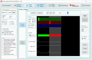

We intend to project the blue patterns and red patterns intermittently using video pattern mode. Specifically, we have 1800 frames of RGB images that need to be projected as blue and red images in a row at 60HZ. Several steps are listed below to explain what we did to achieve our goal.

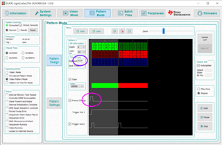

First, we create the pattern sequence on the DLPC900 GUI under video pattern mode. The green channel and red channel are used to control the color of the projected images, as shown in the attached figure. For our case, each image projecting time is 1/ 60 =16667 us, that is to say, the exposure time will be set to 16667 us and the dark time is 0 us for both of the channels. Then each frame of the image will be exposed to 16667 us.
Second, the 1800 frames of images are saved as a 30s duration video in 60 frames/second as the external video source. And we use the PPT as the video-playing media to connect to the DMD via Displayport.
Third, we click the Start button in the DLPC900 interface (see attached image) and start the video (in PPT) at the same time manually. We expect that the output images will follow the sequence that we designed but apparently the result is not good due to the synchronization issue.
overall, the question is how to synchronize the video source and patterning implementation? in other words how can we make sure that the starting time of the pattern and the starting time of the video playing is the same? We know that the PPT is not an ideal playing media in our case, but we are wondering if is there any other video-supporting software that can be used to link with the DLPC900 GUI to start the video source and run the pattern program at the same time?
