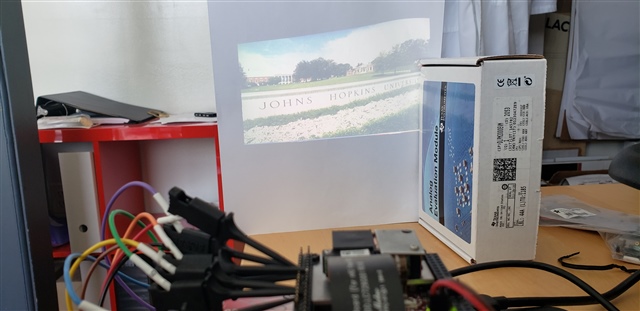

I'm currently working on an application centered around driving a DLPC2607 through a parallel RGB565 interface. In current tests the image is visibly distorted in a way that has me suspect that I am violating one of the timing constraints on the interface. The image I am trying to project is:
but the image appearing on the projector is:
 The above image was written to the DLPC2607 with a pixel clock speed of 6.25MHz.
I know that the issue might also be with the file I'm trying to write or the utility I'm using to write it so I'm reaching out to those vendors as well. But the situation does improve/worsen if I halve/double the pixel clock. The image below was written to the DLPC2607 with a pixel clock speed of 3.125MHz:
So there does appear to be some correlation between speed and distortion that has me think this issue may be timing related.

    I've made some progress on this issue. The distortion seems to be 2 pixels per line. That is, each new line seems to be two pixels short, hence the aggressive left shift.
    I found one of those pixels. Turns out I was writing the first pixel on the same clock cycle that I was asserting DATAEN. That's been fixed and it's improved the distortion and tearing. However, there is still a 1 pixel per line shift at the moment. I've attached an image of the current projection and a new wave capture.
    Will keep looking into things on my end as well, but any help would be greatly appreciated!

    As promised, I've generated two captures that I think will help us get to the bottom of this quicker. They're included in the file: New_data_captures.zip. RGB_capture_firstlastpixel is a black image, except for a blue 1 pixel wide bar on both ends. The idea was that this way I could see the first and last pixel of each line on the data bus and verify that I was clocking out 640 pixels of data per line. It does look like that is the case.
    The other capture is from writing an image with alternating black and white pixels. Similar idea. However, I found that the Saleae sees a lot of glitches on the control lines (VSYNC, HSYNC, DATAEN). I don't think these glitches are real.
    I have not yet tried adding lines to the vertical back porch. The environment I am in makes adding more lines particularly painful so I wanted to at least check the other timing characteristics first.
    I suspect this may have something to do with the vertical sync line delay or total horizontal blanking.
    I solved the problem! I'm not sure which it ended up being ultimately but I have
    A. delayed the deassertion of DATAEN by one clock cycle and
    B. also increased the vertical front porch from 2 to 20.
    The image now renders properly. (see 20230417_110731.jpg) :-)
    Probably ended up being related to meeting the total vertical blanking timing requirement and vertical line sync spec.
    Thank you very much for your help!
