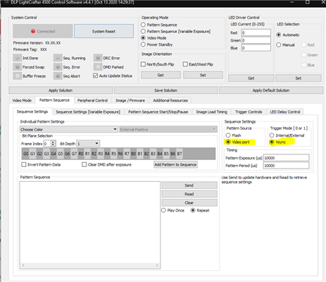

  • Hi Ryo,
    As ALex has pointed out you can not use video mode. But it is possible to use video port in pattern sequence mode. You need to select the source as video port instead of flash image. With these settings you need not store images in flash and can send them via HDMI reducing the flash limitation and also latency(reading images from flash adds latency).
    Hence for your use use I recommend using either pattern sequence mode and can define 1-bit depth pattern sequences. This ensures the input 24-bit data to 24 1bit depth frames as defined.
    Akhil
