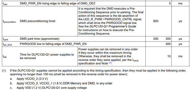

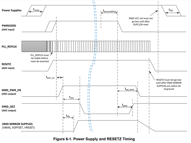

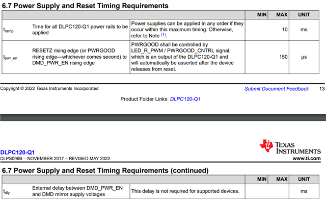

The chip has 3.3V, 1.2V and 1.8V power supply. The specification do not restrict the power-on sequence conditions.Please confirm whether there is no requirement on power-on sequence and delay of the three power.

Please see the following section of the DLPC120-Q1 datasheet.
https://www.ti.com/lit/gpn/dlpc120-q1
