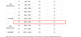

Download 8-8bit stripe pictures, a total of 8, and set the exposure time within the following range:

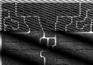

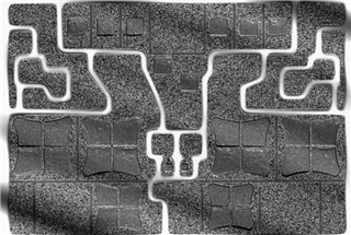

The following is a picture with abnormal picture, which triggered the camera to take pictures.
This projected picture is abnormal left and right, for example, DMD can't successfully load and display the downloaded striped picture.
Half of the projection screen is loaded to show half of a fringe pattern, and the other half of the projection screen is half of other fringe patterns.
(The other half doesn't know whether the DMD loaded the wrong image data or the DMD didn't refresh and load the new image data).
The probability of this occurrence is very low.
The fringe of this projected picture is abnormal, that is, the fringe lines of the same fringe pattern are uneven in brightness.
This kind of appearance is more likely.

      • Download 8-8bit stripe pictures, a total of 8, and set the exposure time within the following range:
      1. Here you are highlighting a 1-bit exposure time though you appear to be sending an 8-bit image. Is this the case?

    1.The probability of the first case is extremely low. In the second case, it is found that it may appear after running for a few minutes, and it may appear in once per cycle of patterns.
    It happens randomly, sometimes one picture of a Set has problems, and some pictures of a set have problems.
    2.Sorry, I can't share the picture, but it is roughly as follows, there are three kinds.
    Sorry, the highlighted position in my picture is wrong. I actually used 8-bit image, and his time is still verified.

    The exposure time of pattern is too short, and it can only be seen by triggering the camera to take pictures.
    We have initially ruled out the problem that the trigger signal is disturbed, and we are doing more tests and verifications.
