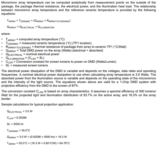

My customer is currently using your company's .66” UHD TRP 2xLVDS Series 610 HB DMD, and would like to ask what is the thermal conductivity of the chip ceramic substrate?Thanks!!!

Sorry for the delay. Please look at the DLP660TE data sheet here: https://www.ti.com/lit/ds/symlink/dlp660te.pdf

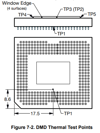

Section 7.6 Micromirror Array Temperature Calculation covers the thermal resistance from the micromirror array to TP1 on the back of the ceramic, which encompasses the ceramic thermal conductivity:
