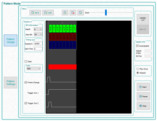

Using the DisplayPort input on the DLPLCRC900DEVM from Windows, the native resolution of 2716x1600 only allows 30Hz whereas 2560x1600 allows 60Hz refresh. Is this a limitation of the board or maybe an incompatibility?
If I use the native resolution I cannot make Video Pattern Mode work using LightCrafter. Although "Locked to External Source" is checked, "Video Running" is not. The picture does not update when I start a repeating 8-bit Green channel sequence triggered by frame changes. I can make this mode work well if I set 2560x1600 at 60Hz (and the "Video Running" box is checked).

    GUI is 5.1.0 and Firmware is 6.1.0.
    At 2716x1600 30Hz in Video Mode, Video Running is checked and the picture updates correctly. In Video Pattern Mode, Video Running is not checked and the picture does not update.
    At 2560x1600 60Hz Video Running is checked in both Video and Video Pattern Mode. The picture does update.
    At 60Hz I have the Exposure set to about 16500us and at 30Hz 33000us, though I have tried with shorter exposures to see if that is the problem. I have also tried both Dual Pixel and Single Pixel modes.
    I see the same problem if I select 2560x1600 30Hz in Windows.
    Unfortunately we really do require to operate at the native resolution. 30Hz will likely not be a problem so long as Video Pattern Mode works.
    Nick

    At the current moment, the DLPC900 controller does not support the native resolution, 2716x1600, in Video Pattern Mode. However, Video Mode does support the native resolution and will run as intended.
    Both Video Mode and Video Pattern Mode are supported at 30 Hz and 60 Hz at the standard resolution.
    Maxine
