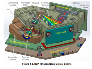

    Thanks, and I want to purchase one DLP2010nir and the supporting evaluation board, however, I cannot find the evaluation board for DLP2010nir, but find a DLPNIRNANOEVM which include the DLP2010nir, can you provide the order link for the evaluation board?
    The DLPNIRNANOEVM is the TI-supported evaluation board for the DLP2010NIR. If you would like to purchase and evaluate a DLP2010NIR, this EVM is currently the only one available from TI.com. However, other EVMs containing the DLP2010NIR are available from Optecks if they suit your application better.
    Maxine
  •  If I perchase the EVM, I would like to take down the optical part from the DLP controller Board, but I want to retain the DMD Board on the DLP controller Board, can I do it? If not, can I perchase a new DMD board?
  • Hello Xie,
    You should be able to use the DMD board from the EVM. TI does not sale parts of components for the EVM.
    regards,
    Vivek
