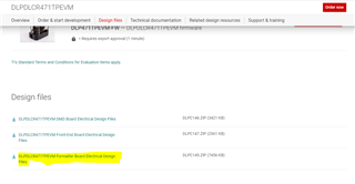

- HI Sir/Mam
- I have the product DLPDLCR471TPEVM and I tested it upon arrival ... the response of the EVM was normal and by that I mean a white Screen was projected out
- The current state is that there is no white screen projection happening or any other projection after connecting the power supply to 19v and switching it on
- The usb is not reading and the PC cannot feel it
- There are some leds on the upper board and there status is ... the PWRGOOD led is on , green  and not blinking ... the POSENSE led is on , red and not blinking ... PROJ_ON led is on green and not blinking ... the Heart Beat led is on blue and not blinking
- Now I understand that I should :
  • Put the "HOLD IN BOOT" jumper across the 2 pins on the header, J9, and then power up. Then try to reload the original flash memory load file.
  • If these step does not resolve the issue then the next step would be to use JTAG using the "USB-to-JTAG cable.
- But I need detailed way (for dummies) for how to do these as I tried the first point But there were no response , And I'm afraid to make more damages
