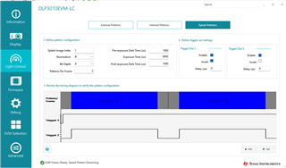

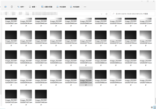

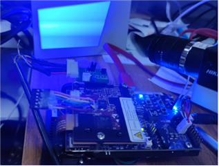

  I have a question for you!I used DLP3010EVM-LC to do Splash Patterns test.My Settings are as shown in picture 1.I used image 4 for the projection. The result captured by the camera is as shown in picture 2. The color of one picture is darker and the color of another picture is lighter. My test environment looks like Figure 3. I used Trigger2 to take trigger shots on the camera. The camera's exposure time is the same as the DLP's exposure time of 8000us.
I don't know why there is a dark color and a light color picture effect. I thought at first that the color of the pictures that came back from the camera was the same. Because I set the bit depth of the RGB three channels of SPLASH IMAGES to be the same. So ask you.

    My theory is that the data is being split up into the upper and lower bits based on the GUI screenshot that you have attached. How do the camera captures appear with a maximally white image?

    My understanding is that when splash patterns is operated, the 24-bit deep image is divided into 3 8-bit deep images, and then 2 8-bit deep images are projected respectively, as shown in PData[7:0] and PData[15:8]. There is no high and low situation as you mentioned. When I made a 24-bit deep picture, I divided the data into three 8-bit deep ones, namely PData[7:0], PData[15:8] and PData[23:16]. These three data channels correspond to RGB channels respectively, and I set the value of these three channels to 130. Therefore, when projecting two pictures, the values of the two channels PData[7:0] and PData[15:8] are projected respectively, and the values of the two channels should be 130, and the brightness of the pictures captured by the camera should be the same.
  • Hello Austin
    My camera is a black and white camera, not a color camera, so the picture shown in picture 2 above is black and white, and the actual projection is a blue picture.
  • Hello Austin
    As can be seen from picture 1 above, trigger1 signals will be triggered every time the projector projects 8 bits of data. Columns such as projection PData[7:0] and PData[15:8] will have trigger signals sent from trigger1. The camera will start to expose according to the trigger1 signal, and the exposure time is the same as the projector exposure time 8000us. Therefore, the camera collected the projection signal of PData[7:0] and PData[15:8] respectively, and I set the data value of PData[7:0] and PData[15:8] on the projector to 130. So the brightness of the picture projected by the projector should be the same, but the actual picture is one dark and one light.

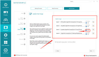

    Here's how I made four splash images. I chose to save in RGB format. My picture format is bmp.

    What's the firmware version and GUI version that you used to create the custom image file that include these splash images? There were some known issues with Edit firmware tool in GUI version 3.1.0.7.
    The latest firmware version for DLP3010EVM-LC is v9p0p1 and the latest GUI version is 3.2.0.6.

    The firmware version I was using was 8.0.0 and the GUI version was 3.1.0.7. However, today I used the latest firmware version 9.0.1 and the latest GUI version 3.2.0.6 as you said, and the same effect still appeared, but it did not get better.

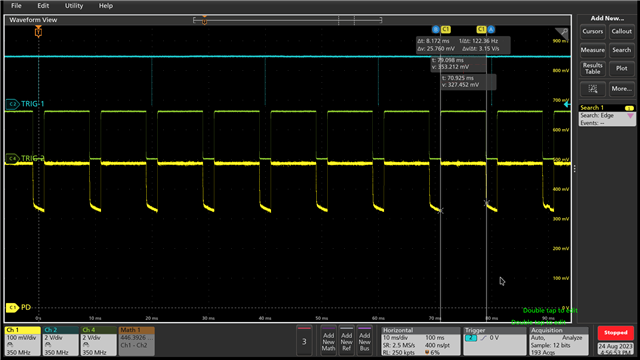

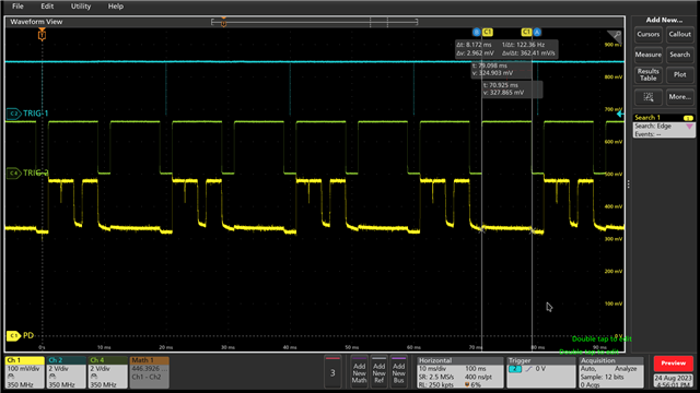

    Do you have a photo detector to measure the light output waveform on an oscilloscope corresponding with Trigger Out 1 and Trigger Out 2 signals?
    I'm wondering that could be the camera cause this issue.
    I had an experience on the TI EVM and captured the waveforms by using the same settings as you shown in the Splash pattern mode.
    Please share the waveforms if you can measure.
    Lori

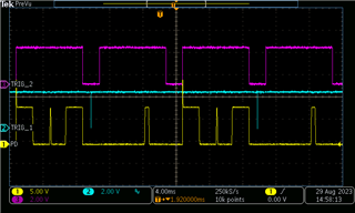

  • Hello Lori Wang,
    I have a photodetector.
    I have two cases here, one is to set the value of the RGB three channels to 255, that is, the value of PData[7:0], PData[15:8] and PData[23:16] are 255. The photo detector and Trigger Out 1 and Trigger Out 2 waveforms appear basically the same on the oscilloscope as yours, and the brightness of the two images projected is basically the same, and there will be no situation where one color is darker and the other color is lighter. There is another situation, if the value of the three RGB channels is not set to 255, the situation as shown in Figure 2 below is that I set the value size of the three RGB channels to 130, it can be seen from picture 2 that the projected two channels measure signals in the photo detector, one is large, the other is basically not. So you have two projected images one darker and one lighter. Since I can't set all three RGB channels of my image to 255 pixels, two images will be projected, one darker and one lighter. How should this problem be solved?
    I don't think it's the camera that's causing this problem, as you can see from my two pictures. When the photo detector projects two images, it does receive signals at the same time, but the signals are large and small, indicating that the projected light intensity is larger and smaller. So I think the reason is DLP.
    Please tell me how I can solve this problem.
    I wonder if it was caused by my splash images with 24 bit depth. I would like to ask how you make 24-bit depth splash images and what format is it.
    I would like to add that the measurement sensor I use is a photoelectric sensor, which converts electrical signals of different sizes according to the strength of the light. The stronger the light, the larger the signal amplitude on the oscilloscope. The PD signal on the oscilloscope is measured by the photoelectric sensor.

  • Hello renzhen,

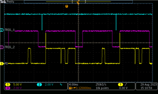

    Please see the captures below by using your splash images. top one is grey130, bottom one is grey30. There might be some limitations in Splash pattern mode to display 2 patterns images. Can you say why you chose splash pattern mode? What's your applications? Are you able to use External pattern mode to display 2D patterns?
