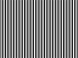

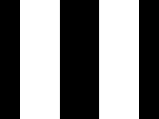

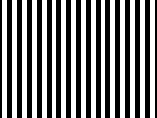

I tried many images and this problem seems to occur when projecting a high-frequency binary (black/white) pattern.
Example
Gray code number 3 (can be projected)
Gray code
Gray code number 6 (blackout when projecting)
Gray code 6

    When opening the specific image (rebooting?)
     D_HOST_IRQ =  ON         D_PROJ_ON = dim?          D_INIT_B =  OFF         D_DONE =  ON         D_P5V = ON
    After black out (rebooting)
     D_HOST_IRQ =  ON         D_PROJ_ON = ON          D_INIT_B =  ON         D_DONE =  ON         D_P5V = ON

    When opening the specific image file, the EVM enters into failure mode (black image, raspi is alive),
    and sometimes automatically reboot but never show the specific image (still black image, raspi is alive).
    Anyone can open this image when projecting desktop? (even not full-screen, it fails.)
    Gray code 9
    Btw, I also tried 5V max6.2A (LTE36ES-S1-301) adapter. This woke the EVM up but the same problem occured.
  • I uploaded the image file to the following URL, accessed by the default browser of raspberry pi, and the same problem occured.
    Anyone can reproduce the problem?
    http://xs523495.xsrv.jp/test/GC_9.png

    I took the gray code 6 image and scaled it to 1080p, then placed it on my raspberry pi. I ran the init parallel script and opened the scaled image. I had no issues with getting the image to display.
    Do you have another model of raspberry pi to try on? We use the 4b model when testing and can't recreate this case.
    John
  • Hello John,
    Thank you for the investigation!
    I tried a raspberry pi 4B as well, and this problem didn't occur in this case.
    So I concluded this is due to a raspberry pi zero 2w.
    It's alive even while the EVM is rebooting, so I guess this problem is caused by unstable signal due to the GPIO characteristics of zero 2w at the high-frequency band. (low drive current?)
    I hope there is a solution to use the smallest setup.
