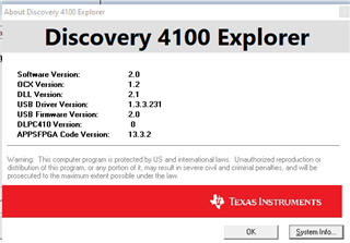

  • Hello Heyang,
    May I ask what version of the GUI you are using and what FW version of the DLPC410?
    This sounds like you are using the earlier version of the APPS_FPGA code with the earlier GUI which loads a bitstream to the APPS_FPGA when the GUI starts running to allow it to communicate over USB.
    With the system attached and running can you open Help/About Discovery 4100 Explorer and post the values from that page?
    Also can you tell me what OS you are running?
    Fizix
  • I am running Windows 10. The Discovery 4100 Explorer page is attached
  • Hello again Heyang,
    Thank you for the screen shot.  You are using the current versions.  When the GUI switches to loading patterns over USB there is a register that switches from Test Pattern Mode to GUI script mode.
    It sounds like that is not happening in the Labview program.  Once the GUI switches it, then it will work.
