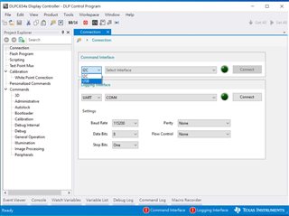

Hi Sir,
OS : Win10 Home Edition 21H2 64 bits
I have download and install FTDI D2XX driver then run "DLP Control Program 15.1.0.26".
But "SPI" interface did not appear in command interface.
Could anyone help me to solve this issue?
Thank you.

Hello User,
It seems like you are using DLPC654X Control program. You can changed the control program for DGP by clicking Product menu -> Dynamic Ground Projection for Automotive.
In the Connection page, you should see the SPI option.
