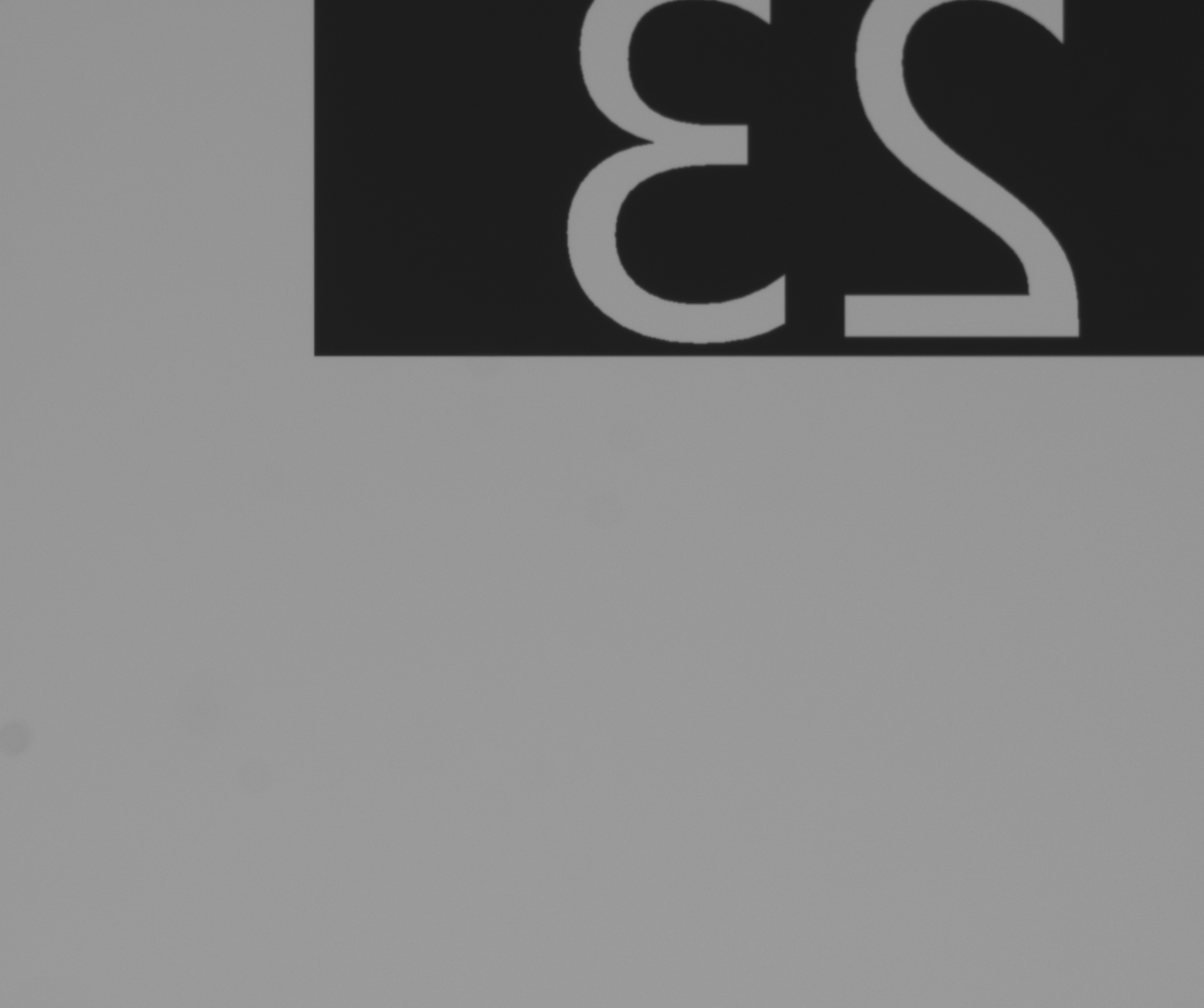

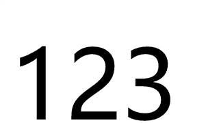

     We start the GUI to project. Sometimes,we find the project map is mistake.Figure 1 is the orginal picture.Figure 2 is the mistake picture.The black an white area is reverse.
            Figure1 orginal picture
                Figure2 mistake picture
   If we use the system setting ,choose Patter  display inverse,sometimes we can get the correct picture,but sometimes ,we can't get the correct one.

          Today I have done the experience again,and I find the rule.
                                          figure 1
                                                                                                              figure 2
                                     figure 3
                                                                                                                 figure4

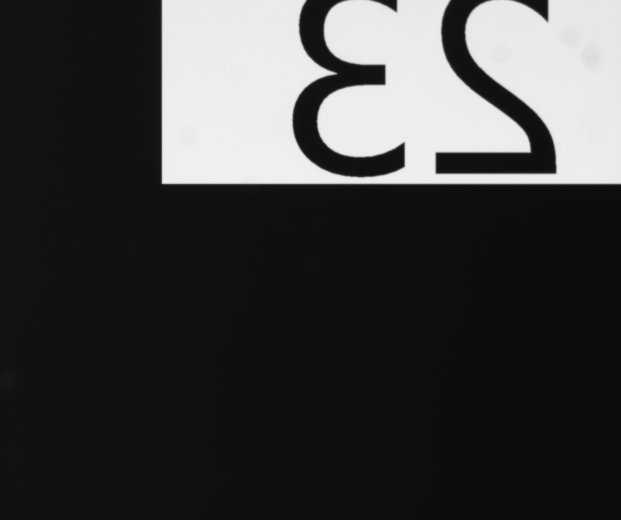

         When I turn on the PCB power and start the GUI, set the figure 1 under the pattern modle.
         First,I get a reverse pic,as figure 2(figure 2 is photoed by CMOS sensor,please neglect the incomplete image just the FOV not matching between CMOS sensor and DMD).
         Figure 2 is photoed by telephone direct from DMD.

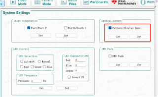

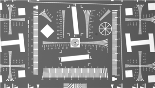

         Sencond,choose the optical invert,update LUT,update is important,get the correct pic,as figure 4.
         I have done the experience three times,and make sure this process is no problem.
         I think we must choose the optical invert as get the correct picture.Maybe we neglect update LUT at the previous experience.

  • Hello again Liping,
    Looking closely at your image of the DMD (Figure 2)n it appears that you are illuminating from the lower left corner of the DMD.
    In your picture the DMD needs to be illuminated directly from the direction of the bottom of the DMD at an angle 35 degrees from the array normal.
    What you see is very much related to the direction of the incoming light and the point of observation.  I think then you will see it as black letters on a white background without turning on "Optical Invert".
