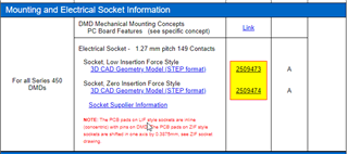

The DLP650LE is in a DLP-S450 (FYL) package, which uses a socket for mounting. Detailed drawings of the sockets are available on the product page under "Design tools & simulation":
https://www.ti.com/product/DLP650LE#design-tools-simulation
There you will find a link to DLPC132:
https://www.ti.com/tool/download/DLPC132
The zip file includes the socket drawings for both a low-insertion-force (LIF) socket, and zero-insertion-force (ZIF) socket.
After extracting dlpc132a.zip, you will find REVIEW_START-Series450.htm that describes and links the various files in the zip file:
These drawings include recommended PCB board layouts.
