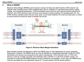

According the snla249 mentioned , there are three part of skew parameter defined .
1.Transmitter pulse variation.
2.RSKM
3.Receiver Strobe Window.
Can you help to clarify in DS of DLPC231-Q1, tskew listed below represent to RSKM or strobe window?
BR Jingcheng

  • JingCheng,
    The Tskew is the same as RSKM from the app note.  In this case of the DLPC230 the max amount of skew for any bit must be equal or less than 400ps.
    See section 6.14 of the datasheet.
    Jason
    https://www.ti.com/lit/ds/symlink/dlpc230s-q1.pdf

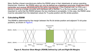

  • Hi Jason
    The RSKM is determinated by UI/Rspos/Tppos parameter, normally the RSKM will not be provided in Datasheet,as TX IC type is unknown.
    Do the 400ps RSKM defined precondition is TX IC has detailcate type defined ?
    0.5UI = 0.5Tppos + RSKM + 0.5Rspos
    BR Jingcheng
  • HI Jason
    If the Tskew is same with RSKM .according the SNLA249 defined, i thinke the Max amount of skew for any bit must be equal or less than (400ps + 0.5Tppos + 0.5Rspos) ,but not 400ps .
    BR Jingcheng
