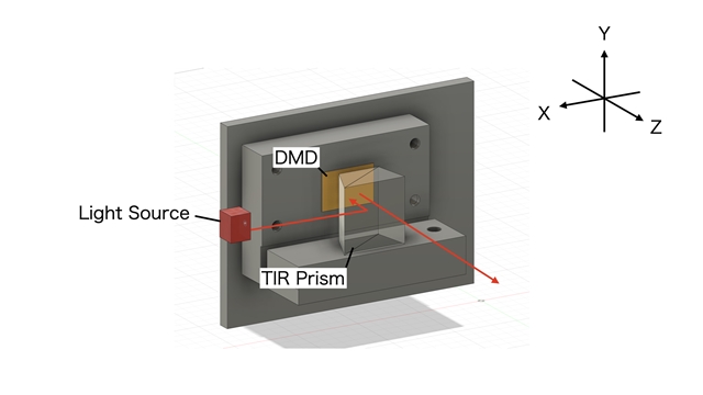

The DLP6500FLQ is placed on the x-y axis plane.
If a light source enters from the z-axis direction, how many degrees should the DLP6500FLQ be shifted in the x-, y-, and z-axes to reflect light from the DMD in the z-axis direction as well?

    From the orientation you describe, the z axis will vertical to the DMD (DMD array normal).  Are you asking how many degrees around the x axis and y axis will the DMD need to be rotated so that the projected angle will return along the illumination angle?
    It might be easier with a drawing showing what you are attempting to get at.
    Are you planning to use coherent light or broad band illumination?

  • Hello Fizix, thanks for the reply.
    I am considering a setup similar to what is shown in the photograph.
    In this setup, the DMD is placed on the x-y plane, but this arrangement doesn't allow for the image to be projected straight in the Z direction.
    I believe it's necessary to adjust the angle of the DMD so that its image is consistently projected straight along the Z axis.
    (I plan to place the projection lens along the Z axis.)
    I tried using a coherent (laser) light source, but encountered issues with laser speckle noise, so I am now using an LED light source.

    First point is that the first reflection in the TIR prism should cause light to enter at 24 degrees from the DMD normal.  Your image shows the illumination coming in at normal.
    Second point is that the TIR prism and the light source will need to be rotated clockwise around the DMD normal by 45 degrees.  Then the out bound chief ray will be normal to the DMD (and therefore your projection optics).  This is because for the DLP6500FLQ (and FYE) the hinge axis is 45 degrees relative to the vertical and horizontal.
    Please see the DLP6500FLQ data sheet page 20.  https://www.ti.com/lit/ds/symlink/dlp6500flq.pdf

  • Hello again Fizix,
    Thank you. I'll try it.
