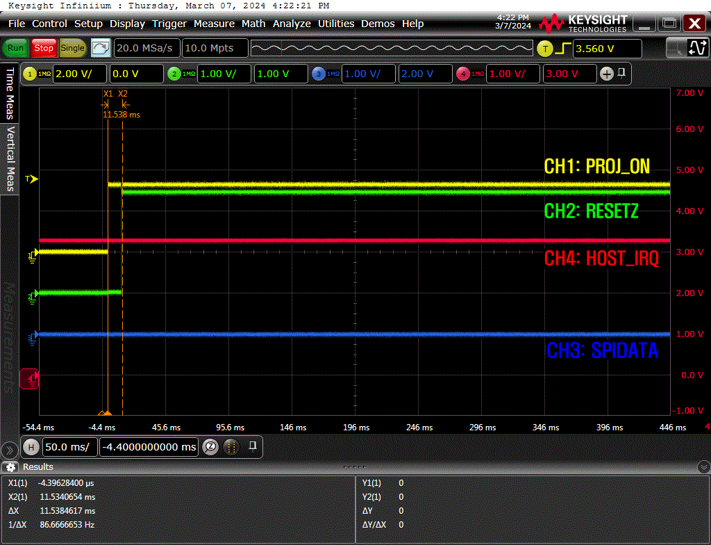

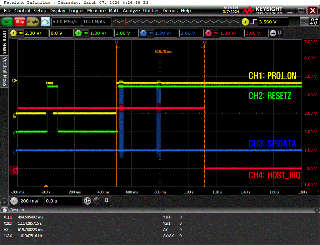

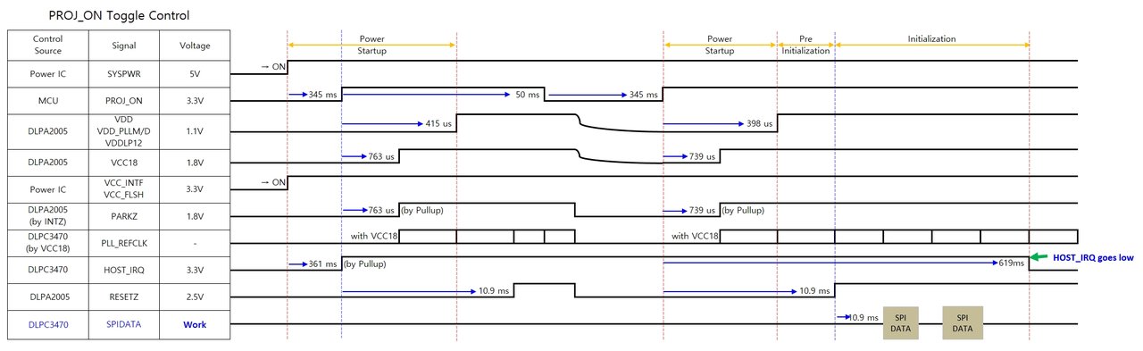

I was currently conducting a development test using DLPA2005 + DLPC3470 + DLP2010LC.
that was design for the Powerup sequence provided by DLPC3470 datasheet, but DLPC3470 Chip cannot read the firmware in the serial flash.
And when PROJ_ON is applied by Toggle, SPI_DATA can be checked.
I will send you the data I measured, and I would appreciate it if you could tell me if there is anything that needs additional confirmation.
