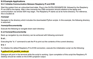

    Have you consulted the following user guide?
    https://www.ti.com/lit/ug/dlpu103b/dlpu103b.pdf
    After setup and configuration (Section 9.1), you should be able to run the init_parallel_mode.py which will initializes video output for 18-bit DPI via RGB666 from Raspberry Pi.

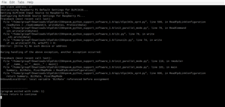

  • I am now unable to run the sample software and this is the error I'm getting when running the init_parallel.
  • To confirm, have you placed the TI provided config .txt file in the boot/ folder of microSD card?

  • As a reference, I have done exactly as the quick start guide has said to no avail.

  • this is the error I got. I am also unable to run the sample codes. I have the i2c bus to 22
    set slave address: 27
    Initializing Raspberry Pi Default Settings for DLPC3436...
    sh: 1: gpio: not found
    Setting DLPC3436 Input Source to Raspberry Pi...
    Configuring DLPC3436 Source Settings for Raspberry Pi...
    Traceback (most recent call last):
    File "/home/groupf/Downloads/dlpdldcr230npevm_python_support_software_1.0/api/dlpc343x_xpr4.py", line 599, in ReadFpdLinkConfiguration
    readbytes = _readcommand(3, writebytes, ProtocolData)
    File "/home/groupf/Downloads/dlpdldcr230npevm_python_support_software_1.0/init_parallel_mode.py", line 78, in ReadCommand
    i2c.write(writebytes)
    File "/home/groupf/Downloads/dlpdldcr230npevm_python_support_software_1.0/i2c.py", line 78, in write
    _i2c.write(data)
    File "/home/groupf/Downloads/dlpdldcr230npevm_python_support_software_1.0/linuxi2c.py", line 74, in write
    if os.write(self.fd, wrbuff) < 0:
    OSError: [Errno 6] No such device or address
    During handling of the above exception, another exception occurred:
    File "/home/groupf/Downloads/dlpdldcr230npevm_python_support_software_1.0/init_parallel_mode.py", line 110, in <module>
    if __name__ == "__main__" : main()
    File "/home/groupf/Downloads/dlpdldcr230npevm_python_support_software_1.0/init_parallel_mode.py", line 101, in main
    Summary, BitRate, PixelMapMode = ReadFpdLinkConfiguration()
    File "/home/groupf/Downloads/dlpdldcr230npevm_python_support_software_1.0/api/dlpc343x_xpr4.py", line 606, in ReadFpdLinkConfiguration
    return Summary, BitRate, PixelMapMode
    UnboundLocalError: local variable 'BitRate' referenced before assignment
    (program exited with code: 1)
    Press return to continue
    I did run the init_parallel_mode.py script with and without the Raspberry Pi attached to the EVM. I got a similar error when I had the Raspberry Pi removed from the EVM. Can you confirm that the ribbon cable is properly attached to both the EVM and Raspberry Pi? The header pins need to be seated all the way in the ribbon cable. Can you confirm that the ribbon cable is not misaligned with either set of header pins?
    John
