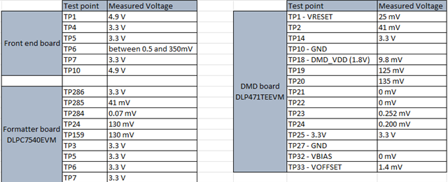

  • Hi Aaron,
    Here is what I measured from the boards.
    Unfortunately, I am unable to find the schematic you are referring to. Page 10 in the User Manual has no schematic. I do not know which test points are the "power banks". TP6 is varying voltage like TP24,159,19 and 20, and the value should be something like 130 mV.
    The LEDs I have mentioned before, but here they are again: D5, D7, D15, D52 - constant green color; D6 - constant red color.
    Thanks. I am looking forward to solving this or getting a replacement ASAP, because our projects are still on hold...
    Dimitar
  • Hello Dimitar,
    Thank you for the information! The schematics can be found under the "Design Files" section of the DLPC7540EVM page.
    I'll have my more effective team members look at this shortly. Thank you again for sending us this valuable information!
    Aaron

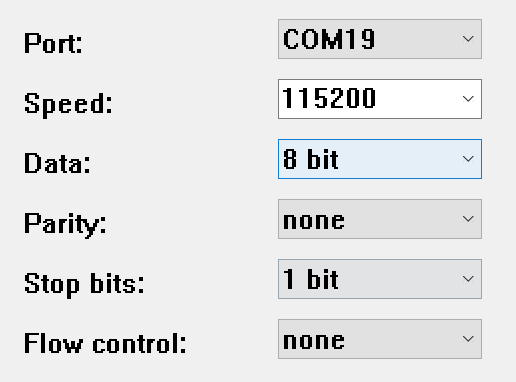

    For the TeraTerm serial configurations I tried both 9600 and 115200 speeds, but got no luck there either.

    I appreciate your patience and am sorry to hear you are experiencing issues with this. I'm getting my team members to respond to you here shortly. They are much more familiar with this board than I am and will be able to assist at a deeper level.
    The serial configuration that we utilize is 115200 speeds.
    Please provide the version of the software you are working with and again they've respond to you shortly.

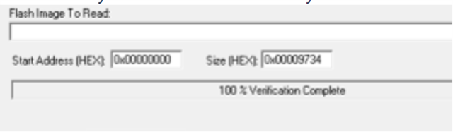

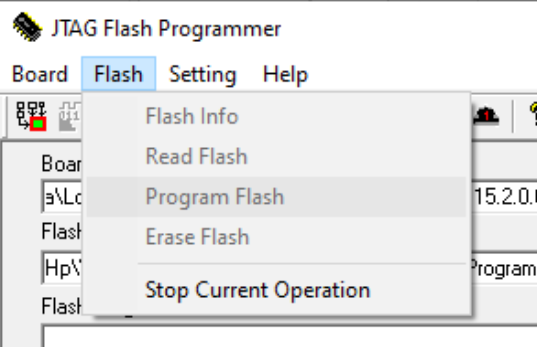

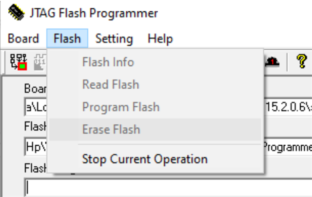

    i have finally managed to try the reprogramming of the bootloader. The short version - it did not work.
    The long version - I ordered all the parts needed and followed your instructions. During the installation the jtag programmer did not display the same image for the chip model as in your instructions.
    However, I was able to erase and install the bootloader and it was successful.
    I found a command called verification (of the flash image) and got the following error after installation:
    I then went on to the next steps of the instructions - to check whether the DLP GUI was recognizing the board.
    It did not recognize it (same as before):
    I also checked Tera Term and got nothing back (same as before).
    To summarize - the bootloader reprogramming was not successful.
    Dimitar

  • Hi Dimitar,
    Ideally when you do the verify flash, it should return successful but you report as failed. After doing the detect chain step (5th step) in the bootloader, can you follow the below steps. Also do not change the size in hex to be 0x80000, let it be the default value.
    1. Read flash info
    2. Click on erase, and erase atleast 15 blocks. Click exit once Erase is completed.
    3. Now click on program icon and wait until it is completed
    4. Click on verify icon and make sure it is successful
    Now continue from Step 8 of the original instructions I sent. Also the chain image being detected as DLPCX54X is okay. Also can you send a picture of the connections you have made, to make sure there is no problem due to them.

  • Hi Siddharth,
    I hope you are doing well.
    After a long period of frustration, I decided to order a new model of DMD EVM board.
    We are able to continue our project and I have finally found some time to give this defective one another shot.
    I did as you said and got a 100% verification.
    I even go the DLP GUI connected.

    To try to troubleshoot again I loaded Tera Term through the J102 Serial Port.
    I received the following output:

  • Hi Dimitar,
    I apologize for the inconveniences caused to you. It is good that you are getting logs on the J102 serial port. I would advice you to place the Jumper J9 first before powering on the system so that the system goes in Bootloader mode when powering up. Confirm from the UART logs that the system has entered Bootloader mode. Now try flashing the official image provided through USB. Then power off the system and move the jumper from J9 to J67. Now power on the system.
    Currently since you have updated the Bootloader, and there is no APP present in the flash image, the flashing of the image might fail due to this.
