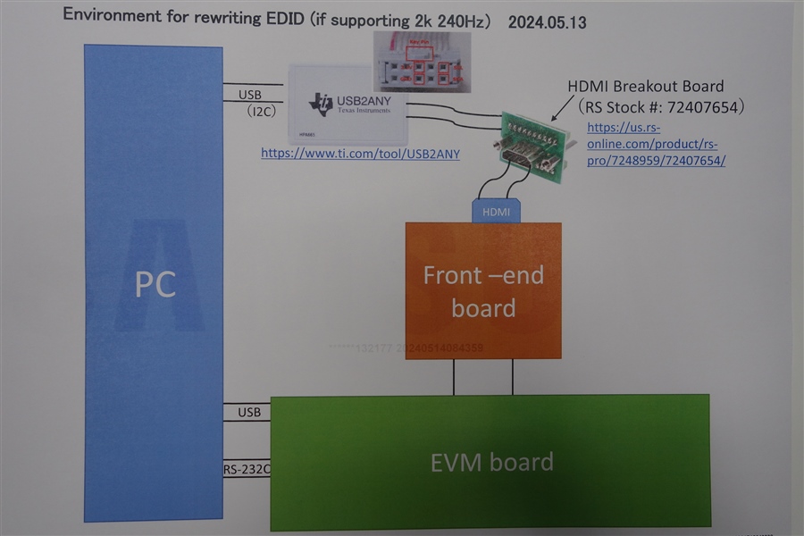

  • Hello Aaron ,
    There are some things I would like to check first.
    1. Do I need to rewrite the EDID on the Front-end board to support 2k 240Hz?  (Yes or No?)
    2. If yes, do I need to prepare the environment as shown in the attached PowerPoint document?
    3. Also, are the things shown in the diagram correct? If it is incorrect, please send me the corrected diagram.
    4. If 3 above is correct, is it okay to use only "DLPC4420AEVMSW-10.1.1-windows-installer.exe" that you told me last time as the S/W? Or "USB2ANY Explorer Installer v2.7.0.0 (GUI FOR EVALUATION MODULE (EVM))" or "SigCon Architect v2.0.0.8" (SUPPORT SOFTWARE) or "PMIC USB2ANY Launchpad Firmware" (FIRMWARE) of the USB2ANY interface adapter. Do I also need “USB2ANY Explorer Software” (SUPPORT SOFTWARE)?
    If so, please let me know the steps to take.
    Change from HDMI to I2C20240513.pptx
    This problem is very difficult for me to solve, so please kindly explain.
    Best regards
    Sasaoka
  • Hello Sasaoka,
    1. This EDID is not programmed currently on the Front-end board, so yes it would need to be written to the board.
    2. Please send me this PowerPoint through another means, it seems to have been corrupted.
    3 & 4 I will wait for this PowerPoint to comment.
    It may be much easier for you to reach out to our regional FAE to discuss this and possibly have them instruct you directly.
    I will take this conversation offline. The resolution is that 1080p @ 240Hz is not covered by the EDID currently and needs to be programmed accordingly.
