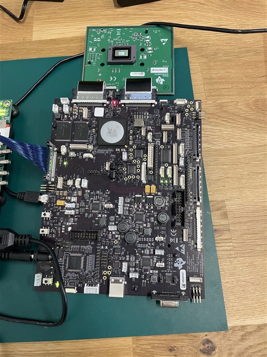

  • Hey Alex,
    Could you send a photo of how you have everything connected? I have a hunch but I'd like to see if there's anything else on the board.
    Aaron
  • That's how it's currently all connected.

  • Hey Alex,
    I noticed that the flex cable going to the front-end doesn't look like our front-end. Could you please advise if this is going to the provided daughter-card for the DLPC7540EVM?
    If this is going to another front-end card, there might be something interfering with the communication.
    Aaron
  • Hey Aaron,
    I am using an FPGA to generate the video input. Unfortunately, the issue still persists when using the provided front-end HDMI to v by one board.
    Alex
