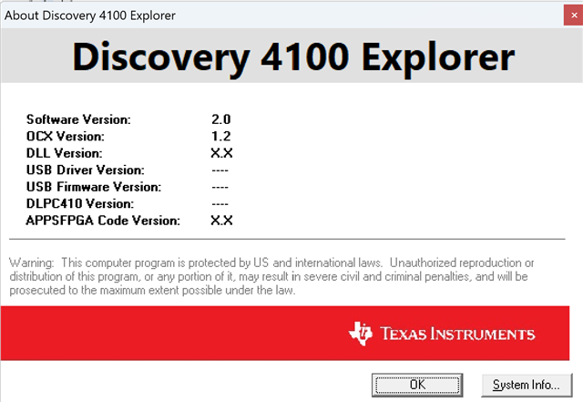

  • Hi Aisha,
    Which version of the GUI do you have? Yours sounds like the older version. Is it v2.0?
    https://www.ti.com/tool/DLPLCRC410EVM#order-start-development
    You should download this version:
    This version has the header files you require. Please let me know if this works for you.
    You can check your version by doing the following:
    Once you have the correct version, you may want to check out any README files
    Michael Ly

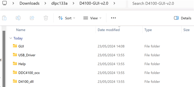

  • Hi Michael,
    I have the same version as you shown, I am attaching about GUI here.
    I think I went wrong somewhere, maybe I never used the header files I have with this software, instead, I download headers from a post.
    Let me install my software again and try to run source file. let's see how it works!
    Will get back to you soon with update.
    Thanks for guide.
  • Hi Aisha,
    Thanks for the picture. This looks correct to me.
    The file name should be something similar to this:
    You can see that going two levels deep into the downloaded zip file (extracted) shows these directories:
    Michael Ly

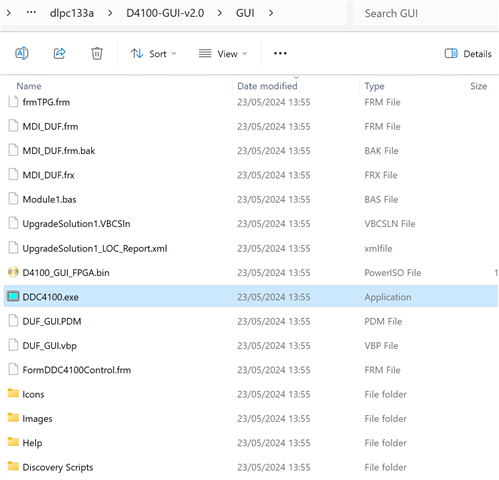

  • Hi Michael,
    Yes these all folders are there in dlpc133a,
    Do I need to install the application?
    There is a file in GUI folder DDC4100.exe but it is simply starting the GUI not installing as an application.
    and if I don't need to install application separately, then should I move this folder from downloads to my Disk??? or what!!!
    Aisha
  • Aisha,
    There is no need to install this onto your computer. The DDC4100.exe file should be able to run without installation.
    The reason I asked for you to install this version was so that you would have access to all the header files you might not have had before.
