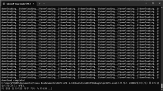

  • Hello.
    No error occurs during the process of calling loadfirmware().
    loadfirmware() is called from the main() function in dlpc347x_samples.c (see picture below).
    When uploading F/W, PROJ_ON is kept at LOW, and if loadfirmware() is executed in that state,
    Host_IRQ remains high.
    After that, if you boot with PROJ_ON set to high,
    The projected image remains the same and I2C works normally. That is, there is no change.

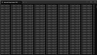

    This is the result of console output by adding pirntf to the code as shown below.
  • Hi Yongjin,
    Thanks for providing this information. It seems from what you are showing the firmware is updated, can you explain what issues you are having with this? What firmware changes are there in the file you updated?
    Maximus
  • Hello.
    From the above, it looks like FW has been updated normally, but in reality, nothing happens.
    (Updated without FW.)
    Updated files are files with no changes.
    As a result of additional testing, we confirmed that all communication is done through I2C in the DLPC API Sample code.
    As far as I know, SPI communication must be used to update the entire firmware.
    There is no content for SPI communication in the sample code.
    Is there any sample code that updates the entire firmware through SPI communication?
    This is the result of additional testing.
    Firmware update using sample code was successful.
    DLPC34XX_WriteFlashDataTypeSelect(DLPC34XX_FDTS_ENTIRE_FLASH_NO_OEM);
    After modifying the code above, the firmware was updated normally.
    however,
    In the initial state without firmware, I2C communication will not be possible, and in this case, firmware update using the above method will not be possible.
    Therefore, as in the question above, a method to update the firmware directly through SPI communication is needed.
