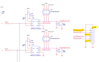

I'm working on a project in which the output of an NIR projector signal is derived algorithmically in real-time based on input derived from an RGB/NIR camera which I am trying to synchronise with the projector.

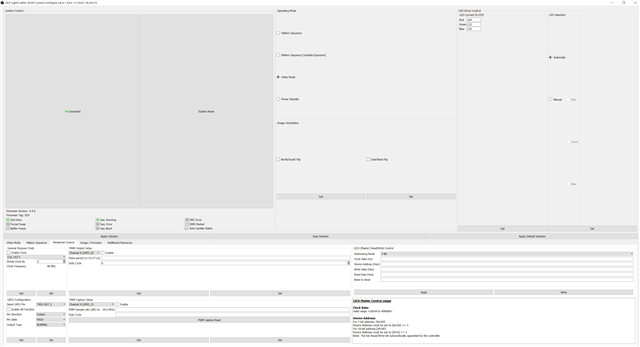

When operating in video mode, there is no output trigger that I can see (via hand-held oscilloscope), and the image comes through nicely:
GUI setting:
Output:
In pattern mode, where I can enable trigger, no video is shown (and also, I believe no trigger signal).
GUI:
Output:
even if I've tried to set the resolution correctly:
May I request a suggestion regarding the best settings for receiving a video signal over HDMI and outputting it at the highest possible quality (pixel accuracy not required) while outputting a trigger signal?
