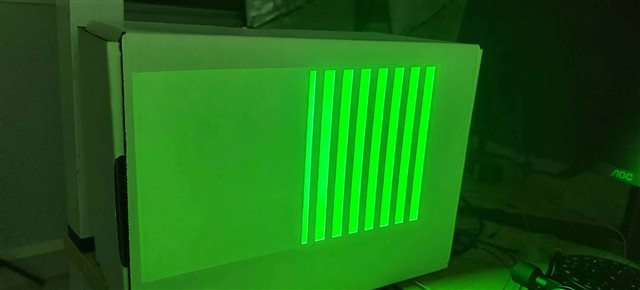

DLP4710EVM-LC: the light control function has some problems that the projector only displays half of the image
Part Number: DLP4710EVM-LC
Other Parts Discussed in Thread: DLPC3479
Dear Support team,
The problem is showed as above. When I use the light control function , the projected pattern only shows half of it and the other part of screen is the homepage picture . However , other fuctions like "display" and "video" are normal. I have tried to update the firmware , but it cannot solve the problem.

          I can confirm that is DLP4710EVM-LC. The firmware version is "dpp3479-dual-ASIC_8.3.0". I can only see the issue in light control mode .The splash mode and test pattern mode are normal.

          The issue is occurred anytime when I use the light control mode. I just set 1D pattern and load them into the projector . Then I clicking the "Run continuously" buttom , the issue occurs. In a word , I follow the steps given by GUI user's guide. Also , I haven't programmed the firmware .
          I remember that the last time the light control mode is normal , I stopped the patterns from displaying and didn't turn off the projector . About 1.5hours later, the projector occurred the issue and it occurs anytime.

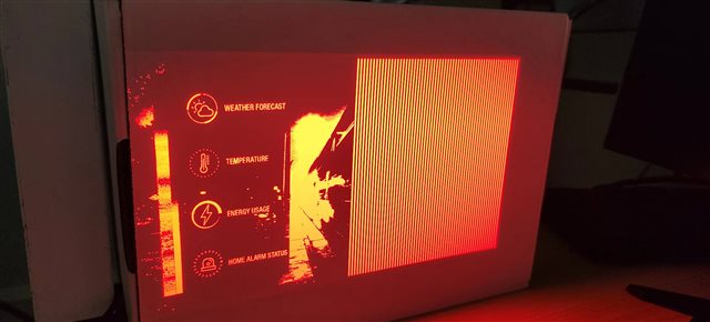

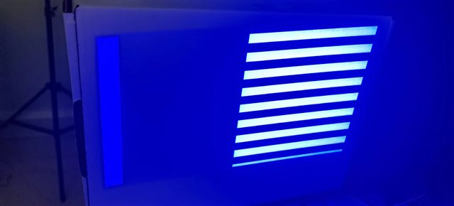

    I can see both D33 and D34 light up in the issue . And they light up since I turn on the Projector ON/OFF Switch(SW21) . I also update the firmware through TI DLP Pico Firmware Selector Tool and the issues still happens . The D33 and D34 still light up since I turn on the SW21.
    Additionally , since I update the firmware , a new issue occur . In light control mode ,sometimes this new issue occurs.
    figure 1
    figure2
    figure3
    figure4
    As you see in figure1&2 , the new issue occurs randomly , in the left part of the screen occurs unnormal patterns . The figure3 is the old issue.The unnormal patterns doesn't occur everytime. And I find that when I use my finger touch the pin2 and pin3 of J9 , the left part of screen will change . Then I use a jumper connect the pin 2 and pin 3 of J9 , as you can see , the issue solved . However , before the issue , the pin2 and pin3 of J9 don't need to be connected. I wonder what make the issue occurs? It seems that is none of the firmware's bussiness , because I re update the EVM's firmware v8.3.0 , the old issue still can be solved.
    Best Regards,
    Zhiyuan Liu
  • Hello Zhiyuan,
    For light control modes pin  2 and 3 of J9 should be connected, do you still see the other issues with updated firmware and pin 2 and 3 connected?
    Maximus
  • Hello Maximus,
    There are no issues. I appreciate your patience!
