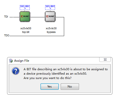

According to the file “the programming instructions in the DLPC410 EVM SPI PROM”, I write the firmware of the dlpc410 to clpc410 successfully, but when I tried to write the firmware of the dlpc410 you provided to me into flash through the JTAG port, the following error occurred and the write failed.
The software version I am using is ise 14.7, and the flash is s25fl032p. I am not sure where the problem may be.

  • Hello Michael,
     I tried different version of ise and different JTAG , and have programmed the flash for dlpc410 FPGA successfully. The reason for the failure is the version of ise. The ise 14.1 is ok while ise 14.7 is not successful and I do not know why this happens.
    1 the revision of the EVM is B as you expected;
    2 the procedure is the same as stated in the file “the programming instructions in the DLPC410 EVM SPI PROM”;
    3 Both FPGAs are detected and the JTAG model is HS2. which are shown here.
  • Hi Jing,
    Thanks for sending me these pictures. Please make sure that you are using the correct bit file for each FPGA. I see that you are getting dialog box you are getting says you attempted to program an LX50 FPGA with a bit file that describes an LX30, which is the DLPC410.
    Please double-check that you are using the ddc4100.bit file for the LX30 FPGA. Then, double-check that you are programming the LX30's SPI PROM with the ddc4100.mcs file.

    To summarize, iMPACT tool v14.7 did not work, but v14.1 did when paired with your JTAG programmer. The *.bit files were assigned to the LX50 and LX30 boards while the *.mcs files were assigned to the PROMs.
