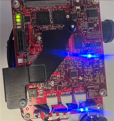

    2.
    Can you check if green LED D6 and D7 are both on and D8 and D9 should both be off on the top of the board?

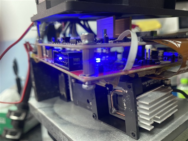

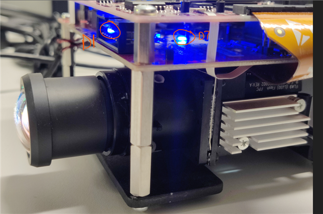

    3.
    Can you check if blue LEDs D1 and D7 are on that are located on the bottom board, these are the 5v and 3.3v rail LEDs to indicate power rails are working.

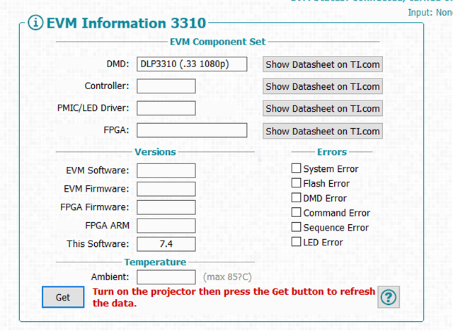

    4.
    Can you connect and read the status information of the EVM from the GUI such as the following below?

  • Hello, I checked the parts you mentioned one by one today, and the results are as follows:
    1.
    I have not made any modifications to the system.And the fan is running normally.
    2.
    D6, D7, D8, and D9 on the top of the circuit board are all lit.
    3.
    Yes, D1 and D7 on the bottom circuit board are both lit.
    4.
    When I connect the screen looks like this:
    Please provide possible reasons for the problem and effective solutions as soon as possible.

  • Hello User,
    Thank you for the information.
    The Green LEDs D8 and D9 should have turned off on the top board it looks like the system may be stuck in boot mode if they are still on.

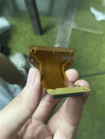

  • Hello, after subsequent attempts to no avail, I tried to replace the original DMD flex cables with another DMD flex cables. Happily, it worked. I would like to share my experience with you here, thank you Alex Chan.
