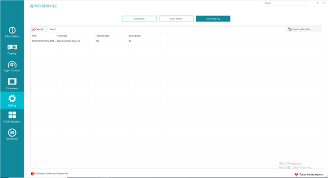

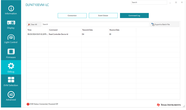

    In the first step, we move the SW28 (PS_ON/OFF) switch to the ON position, and LEDs D43 (+3.3V) and D57 (INTZ) light up, as shown in Figure 1 in the corresponding 'Command Log' screenshots.

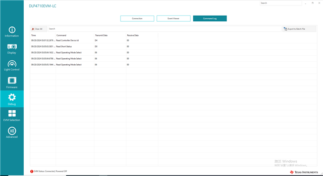

    In the second step, we press the SW21 switch, but LEDs D36 (SYS_ON-OFF), D33 (M_IRQ), and D34 (S_IRQ) do not light up. The corresponding 'Command Log' screenshots are shown in Figure 2.

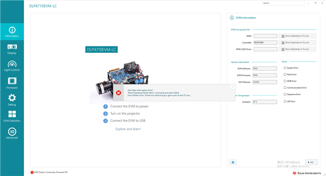

    In the third step, we click 'Information' -> 'Get'. The GUI outputs an error because the second step failed.
    Therefore, we are unable to change the settings of 'Display' to a Test Pattern (e.g., Solid Color - Cyan or something similar) and perform a 'Set'.
    Luo

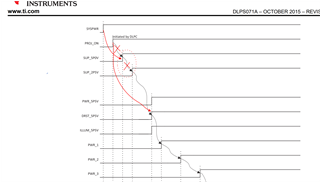

    3. The power-up sequence is not correct from the power management IC ([PMIC] DLPA3005)
      1. Probe through the lines of PMIC power-up seen in Figure 7-1 of the DLPA3005 datasheet
        1. SYSPWR (TP148)
        2. PROJ_ON (TP264)
        3. SUP_5P0V (TP182)
        4. SUP_2P5V (TP183)
        5. PWR_5P5V (TP185)
        6. DRST_5P5V (TP160)
        7. etc.
      2. If fault is seen the DLPA3005 has a hardware issue and return may be investigated
    Please advise if you are still having problems as these steps should identify the issue.

    3. Measured the voltageTP148 highTP264 lowTP182 lowTP182 low _TP183 high Compared to Figure 7-1, the behavior was quite different.

    Please note that you should be seeing the PROJ_ON (TP264) low until you depress SW21, and between SYSPWR and PROJ_ON should have a gap of at least 5ms.
    Everything after PROJ_ON should be automated and this is where we can start comparing the next state.
    Please advise when the sequence is broken with a scope shot of the unintended behavior.

     TP182 and TP183 become high even before SW21 is pressed. (They become high only when SYSPWR is turned on.)
    TP185 does not become high even if SW21 is pressed.

    My team has confirmed that the core voltages as you've found in your PowerPoint do not gate the operation of the PMIC (DLPA3005). The power-up sequence is more accurately shown as below:
    Please note the sequence is reflected to be in this order:
    1. SYSPWR (TP148)
    2. SUP_5P0V (TP182)
    3. SUP_2P5V (TP183)
    4. PROJ_ON (TP264)
    5. PWR_5P5V (TP185)
    7. etc.
    Please continue testing in reference to PROJ_ON to the below power sequences.
