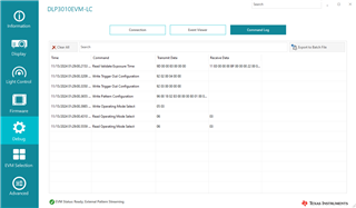

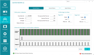

  • Hey Tom,
    Any time there is a response in this thread, I will be automatically be notified.
    If it requires a firmware update, yes the version would advanced from the current version it is now - v9.2.0 for the DLPC3478 controller / DLP3010EVM-LC.
    Could you share what is included in the batchfile?
    If you wanted to check you weren't missing anything you could utilize the GUI for the DLP3010EVM-LC first and then implement all those commands to a batchfile. You can track the commands through the 'Debug' -> 'Command Log'.
    Here's an example:
    Setting to External Pattern Mode: (as an example)
    Now I can implement those commands into my batchfile (read commands are optional).
    This will also show you if your pattern configuration is able to be implemented.
    # 0x96 - Pattern Configuration
    W 36 96 00 01 01 00 01 00 00 00 01 00 00 00 02 00 00
    (1-bit mono,1 Pattern, Red Illumination, Illumination time (us) 256, Pre-Illumination Dark Time (us) 256, and Post-Illumination Dark Time (us) 512)
    This is a valid timing. Are you also writing the Trigger Out Configurations?
    Aaron
