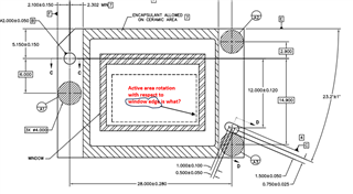

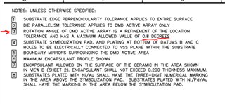

we want to know how much/max rotation of DMD rotate with respect to package... i found this in datat sheet
https://www.ti.com/lit/ds/symlink/dlp651ne.pdf?ts=1731522592891&ref_url=https%253A%252F%252Fwww.ti.com%252Fproduct%252FDLP651NE
is it going to be +/-0.8 or +/-0.4... we are using this DMD for precision optics we kindly need your confirmation ... please see below
thanks
Babak

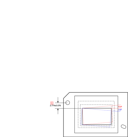

  • Hello Babak,
    It can be +/-0.8°. Please see below figure illustrates this:
    Lori

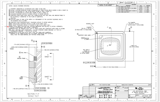

  • Hi Lori,
    we discussed this internally, the hole is referenced to what? a hole is circular does not have an angle.
    I see a better referencing to DLP9000. see below: please see note 12. we need something like that but for DLP651NE:. could you please get with your team and talk to your mechanical engineer to advise and clarify this for DLP651NE:
    Thank you
  • Hi Babak,
    I'm checking with the team and please expected some days delay because the expert is out of the office.
    Lori
  • Hi Babak,
    It's confirmed that the active array rotation angle tolerance for DLP651NE is +/-0.8° related to the horizontal line mentioned in the figure above.
    Our mechanical team notice the note callout on the reference active array size dimensions on sheet 3 should call out Note 2, not Note 3. Note 2 is regarding the die parallelism tolerance that is applied to the active array only that is dimensioned in Section A-A on Sheet 1.
    We will revise the mechanical drawing and make this correction on the datasheet.
