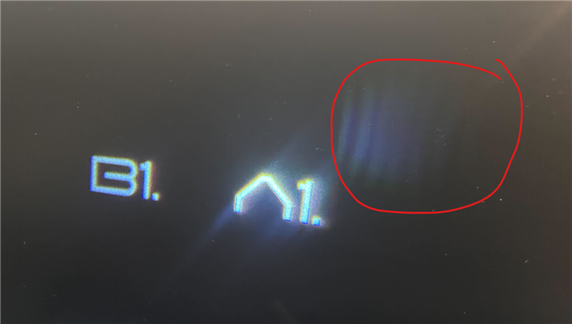

I'm getting the below projection artifact on one of our DLP2021LEQ1EVM units. Any idea what it could be?

  • All screws are fully fastened. There is a light leak underneath the unit on the edge adjacent to the interposer holder. The bottom plate does not seem to be misaligned so I'm not sure why this leak is occurring. See attached images.

  • Hi Will,
    I've just received updates from our optics team as well as another colleague who works on this EVM.
    The DGP EVM uses a field lens design. What you are seeing is a ghost image from the field lens. - Optics Team
    Our other engineer says that this ghost image is expected due to the field lens design above--for DGP designs, this ghost image is only visible in a solid black image case, and it is usually washed out by non-black content such as an OEM logo or animation.
    In a real-world setting, the ghost image artifact is not noticeable on the street/asphalt--as is the case for the DGP projection surface.
    This is a tradeoff: we have a low-cost field lens design with a focal range of 850-1150mm (side mirror height for sedans to SUVs) to avoid having to manually focus each module, but be forced to deal with the ghost image.
    I understand that you are currently in the evaluation phase, but what surface will your final design be projecting onto? What are you currently projecting onto as well? If this is sensitive information, we can take this offline. I'll send a friend request in the case that it is.
    I am marking this thread as "Resolved" because it explains what the phenomena you are seeing is and explains why ghosting occurs. You are more than welcome to comment to open this thread back up by posting another comment, especially because I did ask a couple extra questions.
