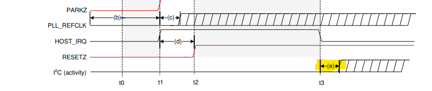

Regarding the timing of DLPC3435's HOST_IRQ and I2C, are there any timing regulations for the period from the falling edge of HOST_IRQ to the start of I2C?
I would like to know if there is a minimum required time regulation.
It is the time (e) in the diagram below.
    Host_IRQ indicated there is some internal processing being done to the DLPC, for this reason we do not recommend sending I2C commands to the DLPC  while Host_IRQ is high. We recommend routing this signal to your front end processor and using it as a "DLPC busy" signal.
    Max
  • I understand that Host_IRQ performs some internal processing for the DLPC.
    I would like to know whether a wait time is required after the DLPC's internal processing is completed and Host_IRQ goes low before the DLPC can stabilize and send and receive I2C.
    If there is a wait time after Host_IRQ goes low so that the DLPC can stabilize and send and receive I2C, I would like to know how long the wait time should be.
    Looking at the startup sequence in the data sheet, there is a gap marked (e) between when Host_IRQ goes low and the start of I2C, so I would like to know how long the expected wait time for this part is.
    There is no time delay required necessarily. Once Host_IRQ has transitioned low the DLPC has completed internal processing and is ready for I2C communication, i.e. Host_IRQ transition is the last thing to occur in the processing pipeline.
