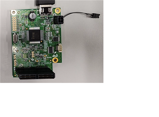

Here is a picture in the EDID Programming Guide for DLPC4420EVM and DLPC4430EVM
Could someone give me more details about how this jumper is connected on ITE6802 Front End board for programming?

Hello Sidong,
Please see the picture below that I circled the jumper. The jumper is used for programming EDID.

Hi Sidong,
The black wires are soldered on Q500 Pin 2 and Pin 3 on the IT6802 Front-End Board. Please see the images below.
I hope this helps!
