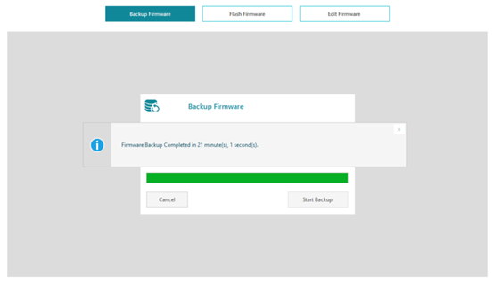

I use “DLP EVM GUI 3.2.0.7” to debug the board by connecting to the I2C port of DLPC3478. Most of the functions are normal, such as test pattern setting in “Display” menu. And Backup Firmware in “Firmware” menu is good, I get the backup file and compare to the origin I burned before, they are of the same.
Base on the above operation, I believe the hardware is good. However, when I try to “Program and Load Pattern” in the “Internal Patterns” menu. It failed. The same error happened in the operation of “Flash Firmware”. After that, I reboot the board, the FW has been crashed, I think at least the Flash has been erased. So I had to burn the FW again, and the board become fine.

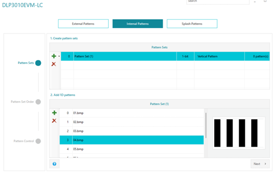

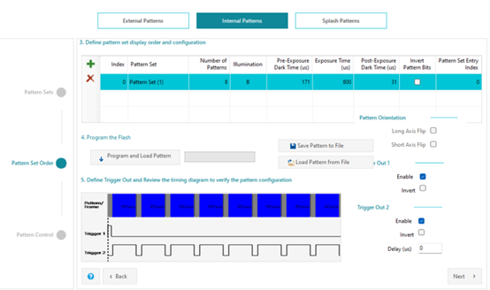

    Could you also share the Pattern Sets page? What are the patterns you've added to the pattern sets? These should only be the type of pattern you've selected when creating the pattern set itself.
    Aaron
  • Hello Aaron,
    Thanks for your reply.

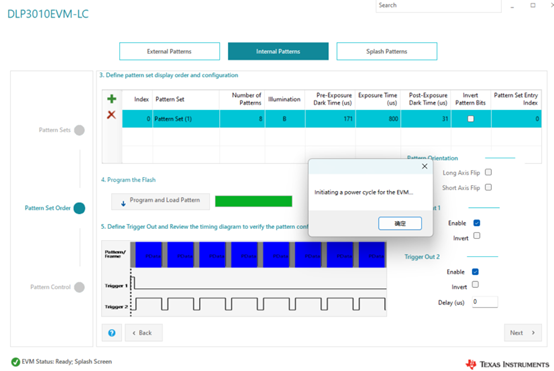

    The following screenshots show my internal mode setting. There is one set which including 8 patterns. Meanwhile the exposure and dark time paras are set. But the error occurs when I click the “Program and Load Pattern” button, it takes several seconds running and pops out a small window “Initiating a power cycle for EVM..”.

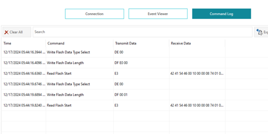

    After the failure above, I check the command log, the final command reading out the data attempt to write into FLASH, it is all FFs. It seems that the data being not written successfully.
    Please help me to analyze.
    Thanks & Regards
    Haoyang Jiang

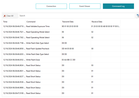

  • Hello Aaron,
    More Info., As I mention if the first E-mail, backup FW in the GUI works fine even though it will take about 20mins in my 32Mbit FLASH. The output file has been compared is identical to the original one. But the Flash FW function fails, the FLASH has been erased and no correct data inside. So DLCP3478 could not boot up. There are some screenshots.
    I’m wondering if the DPCL3478 will check the FLASH ID? Only the valid ID that can be used. The FLASH mounted on board is W25Q32JWSSIQ, 1.8V IO and 32Mbit. Only the voltage is different from the reference design.

    The GUI is quite convenient in debugging. I really want to try it out. In the command list, before programming into the FLASH, "Read Flash Update Precheck" is passed, it means that the FLASH space is enough for the data ready to be written. All the steps seams OK except the final command "Read Flash Start", the output content is all FFs.
    So the size of Flash should be enough. How about the SPI communication speed? Could it be config to lower down? I check it by oscilloscope, the CLK of SPI is about 30MHz.
    Thank you.
    Haoyang Jiang

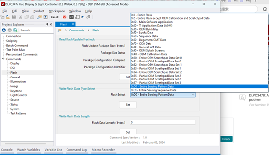

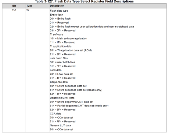

    One more Info., in the GUI Advanced Mode, "Write Flash Data Type Select" has more paras such as 0xD0-Entire Sensing Pattern Data. However in the "Programmer’s Guide" DLPC3470 and DLPC3478 Software Programmer's Guide, the file name is dlpu075b.pdf, in the page 82, there is a paras table which has fewer paras and no 0xD0. I think it's strange. Why? Am I missing something? The following are two screenshots to be compared.
    Thank you.
    Haoyang Jiang

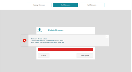

    Can you help me in understanding the following things.
    1. How are you flashing the FW image after it gets corrupted
    2. Did you try flashing the FW image from the GUI firmware update.
    3. Could you please share the schematics of the system over personal message
    Kirthi Vignan.
  • Hello Kirthi Vignan,
    1. I use a USB to SPI cable to flash the FLASH again. In my board, there is two SPI masters facing the FLASH, one is DLPC3478, the other is my USB to SPI cable. If I want to flash the whole FW, I plug the cable and set the RESETZ signal low, hence the SPI port of DLPC3478 will be tri-state. The FW can be programed successfully. When the system in normal operation, I just need to take away the cable, DLPC3478 is able to boot up from the FLASH.

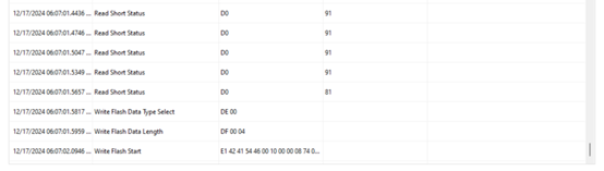

    2. Yes, I've tried to flash the FW from GUI. The first step of erasing is done, but the second step is failed immediately. Let me show you the screenshot at the end my E-mail. So the result is unsuccessful.
    3. It's OK.
    Thanks & Regards
    Haoyang Jiang
  • Sorry for forgetting to post the screenshot.
