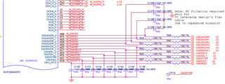

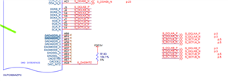

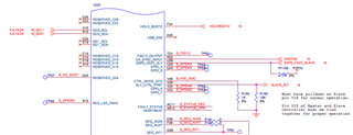

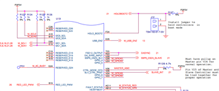

  • Hello James,
    The GUI does not require the DMD to be installed to update the firmware.
    It looks like the Primary controller is not able to communicate with the Secondary controller. Those are the I2C Read/Write failures that you see in the Primary's debug logs. Can you verify the I2C bus between the Primary and Secondary?
    I would suggest to perform experiments with the DMD uninstalled to prevent damage.
    Thank you,
    Aishwarya

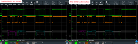

  • Hello Aishwarya,
    The I2C measurements are the same with or without the DMD installed.
    With the DMD installed, updates can still be made, though the commands don't seem quite right.
    Here’s the UART data received when the DMD is installed:

    Aside from the HDMI being removed, the I2C circuit matches the EVM.
    Currently, the I2C pull-up resistor is 1kΩ, and I’ll try testing with different resistor values.
    Thank you!
