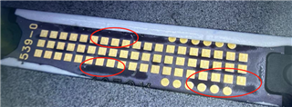

    In addition, there is a known problem on our machine, that is, there is liquid at the metal point on the back of DMD.
    As shown below:
    I guess it may be that the cooling pad on the back of DMD reacts with air when it is heated, thus producing water.
    Because there has always been such a phenomenon from the design section, the probability of bright spots before is very low.
    I can't confirm whether this water has pure water or other ingredients, and I can't confirm whether it has anything to do with the bright spot of DMD.
